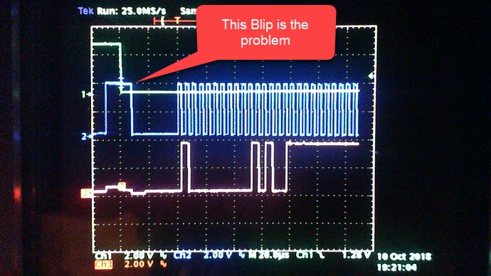

Using SPI on the Neo Air SPI does not work properly. The clk line is not stable low after CS goes low as you can see here.
#!/usr/bin/env python3
import time
import spidev
MCP23S17_MANUF_CHIP_ADDRESS= 0x40
MCP23S17_CHIP_1=   0x40
MCP23S17_CHIP_2=   0x42
# Used For 16 bit mode ONLY
IODIR=           0x00
IPOL=            0x02
GPINTEN=         0x04
DEFVAL=          0x06
INTCON=          0x08
IOCON=           0x0A
GPPU=            0x0C
INTF=            0x0E
INTCAP=          0x10
GPIO=            0x12
OLAT=            0x14
spi = spidev.SpiDev()           # create spi object
spi.open(0, 0)                  # open spi port 0, device (CS) 0
# Set SPI speed and mode
spi.max_speed_hz = 200000
spi.mode = 0
#spi.cshigh = True
#spi.lsbfirst= True
#spi.bits_per_word= 8
spi.xfer2([MCP23S17_CHIP_1, IOCON, 0x0c, 0x0c])
spi.xfer2([MCP23S17_CHIP_1, IODIR, 0x00, 0x00])
spi.xfer2([MCP23S17_CHIP_1, GPPU,  0x00, 0x00])
spi.xfer2([MCP23S17_CHIP_1, IPOL, 0x00, 0x00])
spi.xfer2([MCP23S17_CHIP_1, GPINTEN, 0x00, 0x00])
spi.xfer2([MCP23S17_CHIP_2, IOCON, 0x0c, 0x0c])
spi.xfer2([MCP23S17_CHIP_2, IODIR, 0x00, 0x00])
spi.xfer2([MCP23S17_CHIP_2, GPPU,  0x00, 0x00])
spi.xfer2([MCP23S17_CHIP_2, IPOL, 0x00, 0x00])
spi.xfer2([MCP23S17_CHIP_2, GPINTEN, 0x00, 0x00])
spi.xfer2([MCP23S17_CHIP_1, OLAT, 0x00, 0x00])
spi.xfer2([MCP23S17_CHIP_2, OLAT, 0x00, 0x00])
try:
    while True:
        spi.xfer2([MCP23S17_CHIP_1, OLAT, 0xff, 0xff])
        time.sleep(0.3)         # sleep for 0.1 seconds
        spi.xfer2([MCP23S17_CHIP_2, OLAT, 0xff, 0xff])
except KeyboardInterrupt:       # If Ctrl+C is pressed,
    spi.close()

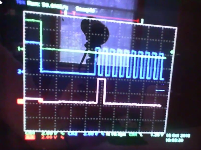

Here is the scope capture running the same python code on the Neo Core2, which works fine, as can bee seen here.
