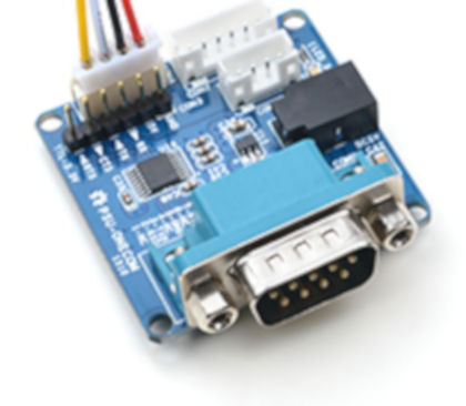

I see there is a way to buy a separate board called TTL To RS232 Module PSU-ONECOM that has VGA (RS232) on it, but I was wondering how to connect nanopi neo2 via HDMI to my monitor? Right now I can connect via serial bus using USB2UART and software Putty, but I'd much rather prefer to have the desktop output (GUI) of the Ubuntu 16 that's installed in nano pi neo2.
Also, this TTL To RS232 Module, how does one connect mouse and keyboard to neo2 computer? To one of the other pins?
The blue connector isnt VGA. Its a DB9 serial-RS232 connector.
The NanoPi Neo2 hasnt Video-Out - so you cant connect VGA or HDMI.
The NanoPi Neo2 is build to use it headless (without a monitor) and only remote or via the serial Debug-Port.
