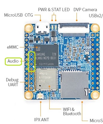

I have a problem with the analog audio on the nanopi neo air board.
I plugged a passive speaker on LR & GND pins (PCB v1.1)

BUT the Pins for LR & GND on the mainboard are not the pcm5102a? the pcm5102a should be an audio hat-board?
I dont know if the LR&GND Pins are using the HDMI-Audio on card 1 device 0?

You probably right with Pcm5102a. So are we sure, audio pin on mainboard are hdmi ?

a PASSIVE Speaker could be much to quiet.... you need an speaker with amplifier.
And with Amplifier and the right asound.conf you also have to raise the volume inside the alsamixer...
Which Audio-Out device is shown in the alsamixer?
LR is loudspeaker right (do you have soldered in the four pins of the audio at the inner row?)
