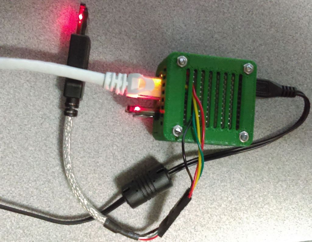

Just took a chance and hope I would not mess up my NanoPi NEO.
Used jumper wires and plug them in and got it the 1st time.
Put a small SD card on the USB and it started to flash it's little LED so I was sure it worked.
Did a Fdisk -l before and after and it sees it.

Pin 1 is near the SD card that plug in on the board. So it's 5 volts and at the other end is the ground. Right next to the 5 volts I plug in the D+ and next to that the D- because it says "USB-DP1" and "USB-DM1" that I guess "P" is Plus and "M" is Minus.
Here is a photo I got of it.
Wow nice can just plug it right in. It has one more USB can use too.
