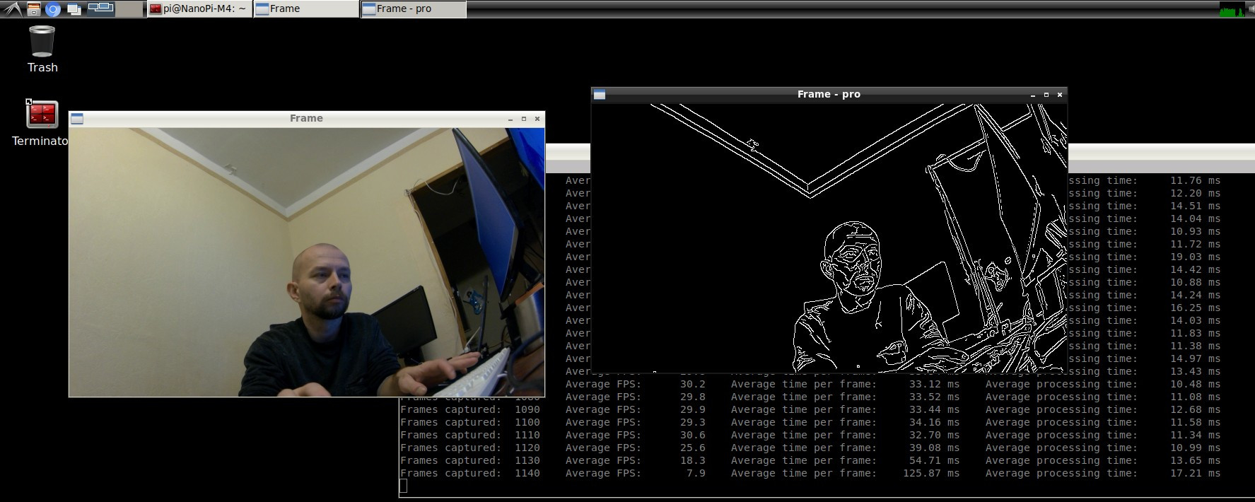

simple screenshot from OpenCV test on NanoPi M4/sdcard you can find in attachment
Unfortunately, framerate can't be changed and it's always 30fps)

Of course it's interesting to try a speed of over 30FPS.
Can't get over 30 fps :(
