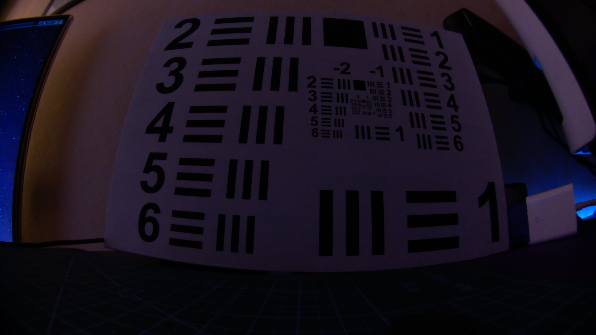

I use the MCAM400 with a nanoPi M4 (image rk3399-sd-friendlydesktop-bionic-4.4-arm64-20201027).
Image is very dark when there is not much light so I think there is no AEC or AGC.
Do you know how I can enable it if there is ? Or do you know how I can access to registers to set gain by myself ?

I changed the lens to have more angle and with current image (rk3399-sd-friendlydesktop-bionic-4.4-arm64-20201226.img.zip), camera output is very dark (photo in attachment).

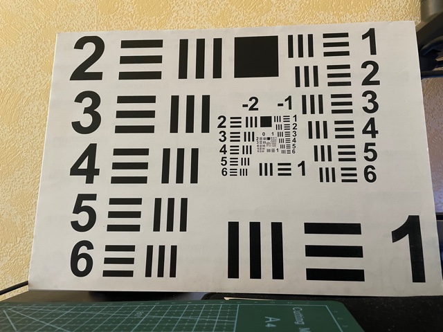

Sorry for really delayed answer - just manage to get to hardware - please find follow examples:
- auto(gstreamer)
- manual: exposure 0.01sec, gain(analogue) 8
- manual: exposure 0.01sec, gain(analogue) 16
- manual: exposure 0.029sec, gain(analogue) 8
Looks like I can'ts add link to images from google drive - so link to folder with them - parameters coded in file name
https://drive.google.com/drive/folders/ ... CUS-jLJs0B

Thanks, i am able to pass the correct params with kernel 4.19.161 and have a bright image, really bright :).
Just need a better denoise filter, just as the FE 4.4 has.
./rkisp_demo --device /dev/video0 --count 15 --width 2688 --height 1520 --format YU12 --gain 2 --expo 0.031 --output test_gain2_ov4689_2688x1520.yu12

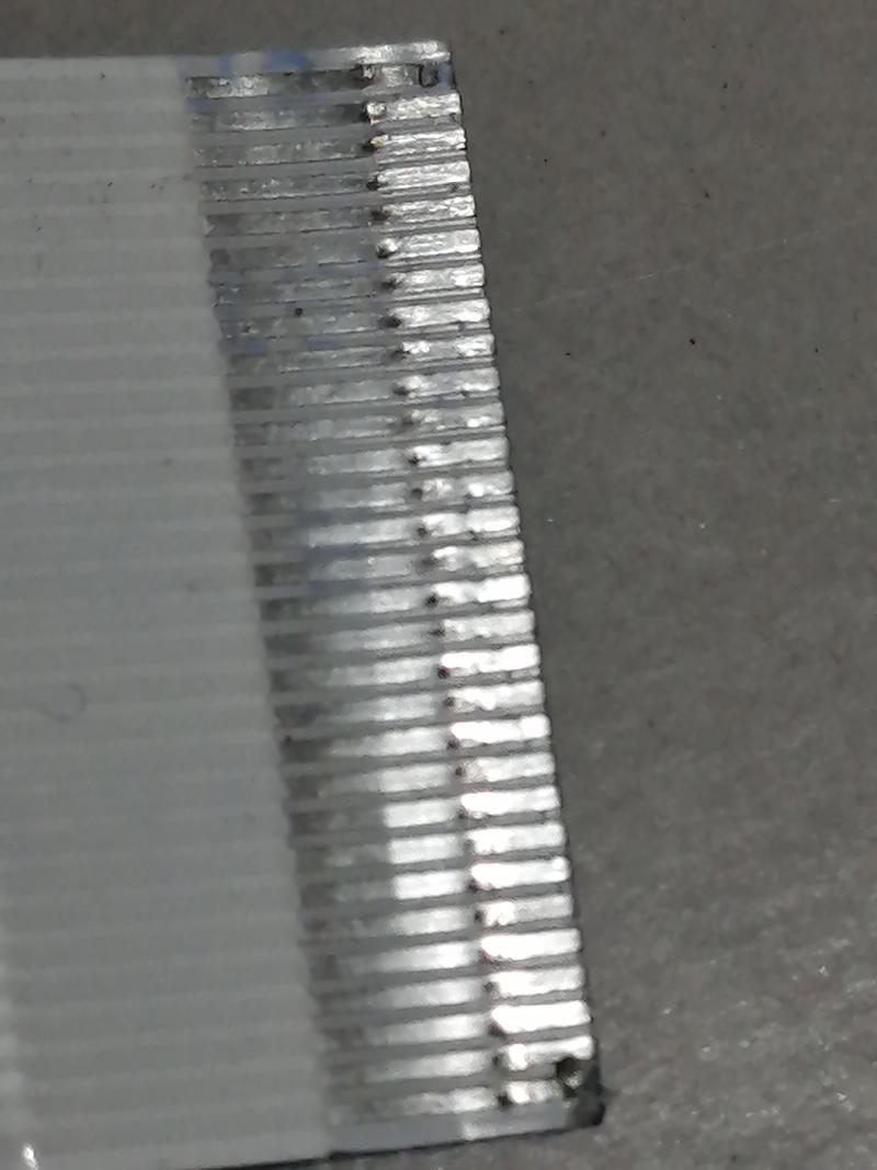

Just for the record, i just received a new sensor and found out the error reported here is due to a short on the last track of the FPC, luckily the sensor was not damaged. Changing the FPC was the fix.
