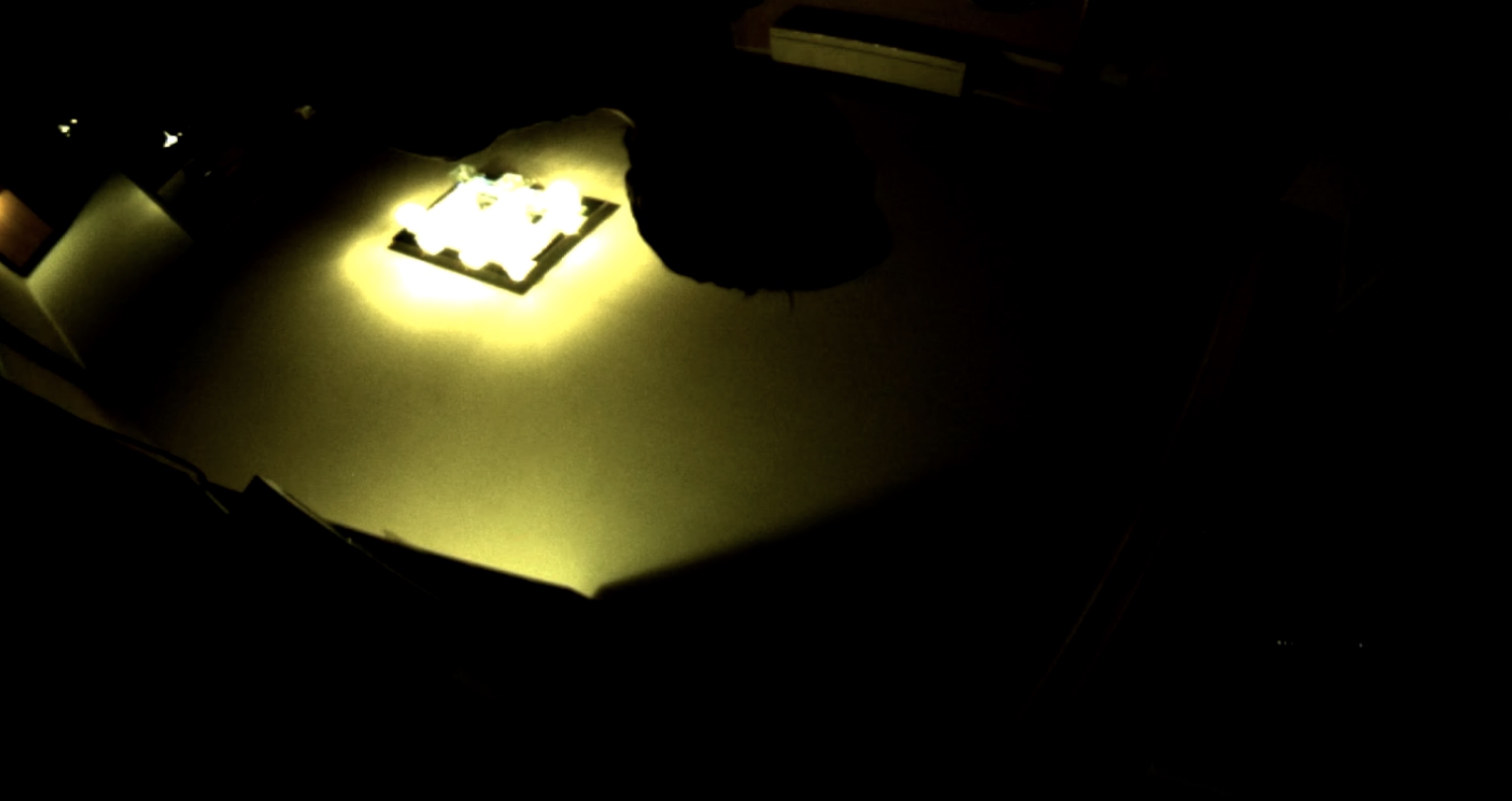

We're working on making OV5647 camera (15 pin CSI cable, https://www.waveshare.com/rpi-camera-b.htm) to work with SOM-RK3399v2. We managed to adjust device tree layer and the camera works and we can see the image.
However, the image is quite dark and greenish. After searching we identified that this can be related to missing iq file.
During the streaming start process we get:
XCAM ERROR rkisp_control_loop_impl.cpp:166: can't access iq file /etc/cam_iq/ov5647.xml
Here is the example of the image / video quality we have:
I suspect this can be resolved with adding iq file ov5647.xml to /etc/cam_iq. However, this file is missing everywhere. Could anyone suggest the solution please?

Thanks for the suggestion Lex! Unfortunately, this file belongs to different RkISP version and it complains about versions mismatch when initialising the stream. Changing version in xml file to required removes the warning but the quality even worse.

ayaromenok, many thanks for sharing the link! I'll be able to test with OV5648 xml for OV5647 and then report back here about the results.
