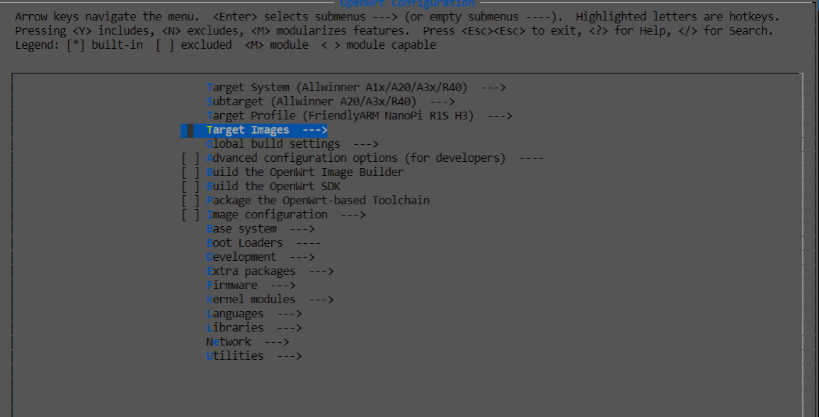

https://github.com/jayanta525/openwrt-n ... -r1s-h3-h5
Here is the source code for openwrt with NanoPi R1S-H3 added.
Follow the normal procedure of compiling OpenWrt.

Thanks ... i dont have x86 with linux ... so yestrday i start building on RPI4 (my first build openwrt :-D ), image are done. Today i will test them if they are OK.
I hat little problem on start because i overloked the diferent branch on GIT. But at the end i find my way eventualy.

so id dosend work ... even you precompiled img dont work.... i can conect to device ... it gives mi wierd ip 169.254.56.172 web base luci dont running and ssh dont accept empty passwrd.
the r1s-h3-h5 build wifi dont runn so i think it dont boot properly.
