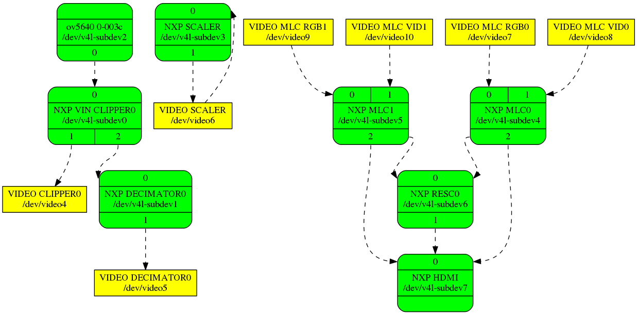

Any example how to use the camera CAM500A with Debian?
the Android image works fine with the camera, but for Debian the wiki does not provide any usefull info (yet, I can add it after it works). Wiki only talks about a USB camera.
In dmesg I see the probe for the the ov5640 driver gets called and there are many /dev/videoX (X= 4..10), also quite some V4L2 subdevices.
None of the videoX looks like the camera though. I tried many camera apps and all videoX devices. None works.
(I could check how Android does it if only the adb would work - see my other post).

I am working on a solution right now.
With the tool mediactl I created a png file with graphics. (attached)
The /dev/video4 should be the right one (and /dev/v4l-subdev2). But they wont work until mediactl does actually connect them.
After created the medictl script I will post it here (or better to wiki?).
