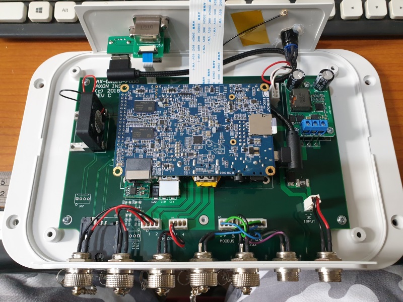

Out of curiosity, what are you using the T4 for? I've attached the logger I designed with the T3 Plus which is used to read the data from a pressure/temperature sensor installed in an oil or water well. It also controls the VSD and I have a small 0.75kW one for testing as shown in the attached images. The T4 will be used as a touch interface for an ROV Control System.
