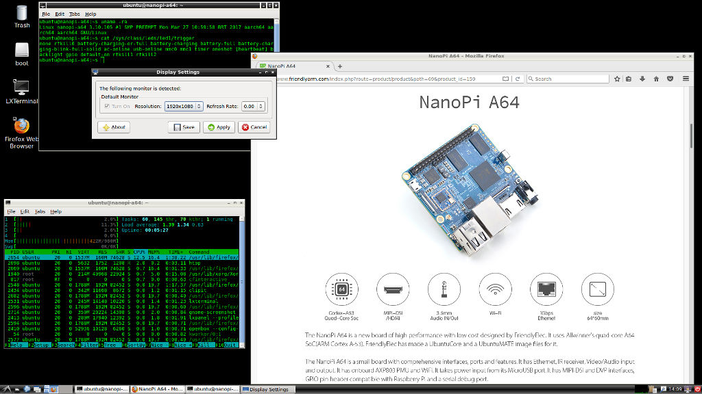

BUT I did found something that does make a useable board out of the NanoPi A64 :)
Here at this Page you could find a Ubuntu 16.04 xenial with LXDE-Desktop:
https://github.com/avafinger/nanopi-a64-firmware
The only thing with that is that creating the bootable MicroSD-Card is a little bit dificult,
but the instructions in the bottom of the page are quite well :)

I also switched from 1080p to 720p
cd /media/ubuntu/boot/a64
cp a64-2GB.dtb a64-2GB.dtb_1080p
cp a64-2GB.dtb_720P a64-2GB.dtb a64
reboot
Now my NanoPi A64 is updateing the xenial via apt (170MB to go)....
Welcome to Ubuntu 16.04.3 LTS (GNU/Linux 3.10.105 aarch64)
Linux nanopi-a64 3.10.105 #1 SMP PREEMPT Mon Mar 27 10:59:50 BRT 2017 aarch64 aarch64 aarch64 GNU/Linux
